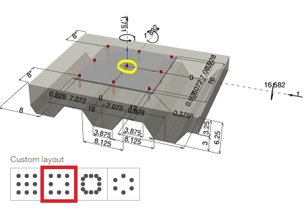

Good morning,
I am curious if you intend to provide the same functionality for anchorage into top of concrete over metal deck that exists for anchorage into slab. Primarily the ability to remove anchors centered on the base plate of a multiple anchor design. See attached image circled in yellow.
You can remove and manipulate anchorage locations when designing for anchorage into slab via the "Change to 2D" tab but this functionality does not exist when anchoring to top of concrete over metal deck. Another way to make this happen would be to add a few more preset anchor layouts to the "ANCHOR LAYOUT" tab. See attached image.
Not being able to remove this anchor makes stanchion design difficult & this added functionality would be very helpful.
Thank you.

Hi Kyle,
Thank you for your suggestion. We will forward your request to the software development team to look at adding this feature into PROFIS Engineering.
