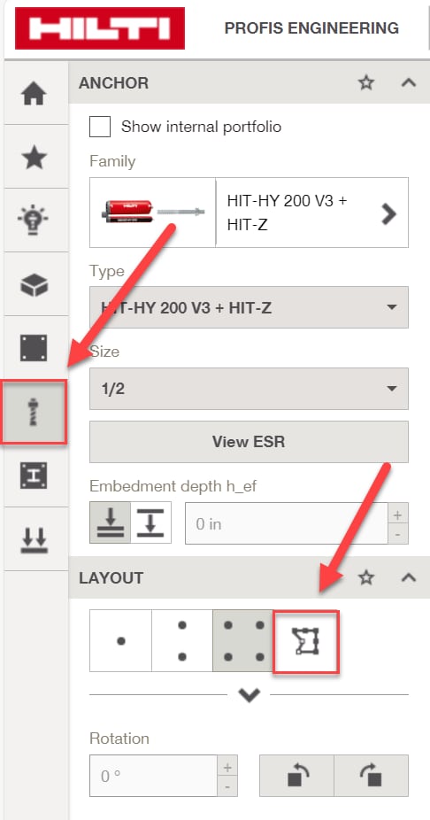

Hi there. In the past, Profis has allowed users to set custom anchor layouts. Is this still possible?

Hi Avro,
Yes, this is still possible. PROFIS Engineering allows for custom anchor layouts within the "Anchors" tab of the Anchoring-to-Concrete module.
