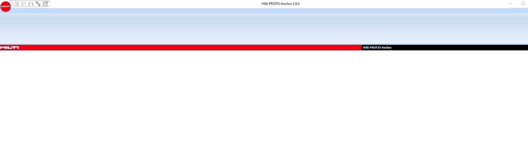

I have a project that I'm in the middle of. I have some anchors designed with Hilti Profis Anchor 2.9.4. Now if I try to review or modify the anchor selections, Profis does not load. The anchor calculations were completed less than 2 weeks ago.
Has access to Profis Anchor been terminated?
Will all new modifications to existing anchors need to be recreated in some version of Profis Engineering Suite?
Profis Software,not running

PROFIS Anchor is no longer available for use. You are able to import your PROFIS Anchor files into PROFIS Engineering and continue your design in the current software. For further assistance on how to import the file, please reach out to Hilti’s Engineering team at 877-749-6337.

Thanks for the update. I had one computer stop running Profis Anchor Tuesday, and was able to get a couple more designs completed on a second computer Wednesday. But, now that one as stopped running it also. I'm using the online version 3.0.76 now. Will this be available as a version installed on a desktop or will I always need to have an internet connection to get it to run? Thanks again.

Currently, there are no plans to create a desktop version of PROFIS Engineering.
