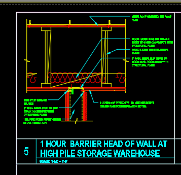

Head of Wall fire rated barrier
One hour rated I joist roof / ceiling with one hour metal stud partition head of wall condition. Does HILTI have a UL product for the head of wall joint condition for a U 400 series wall. Please note CA SFM will not allow EJ's. I have searched UL I Q and have not found a listing,

Hello,
Thank you for reaching out to the Hilti Fire Protection Design Team to assist you with your firestop engineering needs.
Unfortunately, we do not have a system for this application. All of our existing systems are for wood framed walls meeting the roof/ceiling assembly. Since you have a steel stud wall, this would need to be an Engineering Judgment which will be a custom detail showing your exact application with the firestop components required to maintain the stated ratings.
