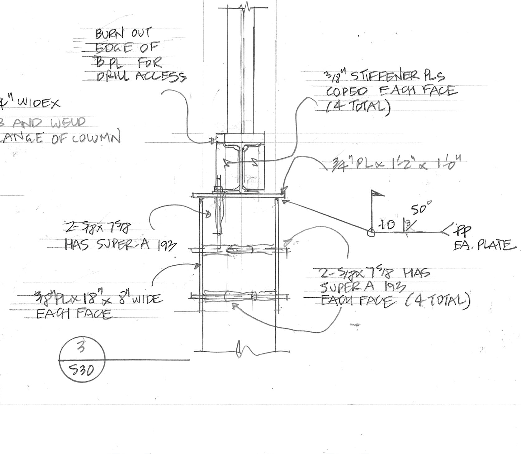

My engineer is asking for 2⅝ x 7⅝ HAS SUPER-A 193 anchors. What is the Hilti equivalent?
ASTM A193,Single anchor

Hi Dom,
See Section 3.2.7 of the Hilti Anchor Fastening Technical Guide for a list of Hilti’s threaded rods. Rods that have an ASTM A193 approval include the carbon steel HAS-B rod and the stainless steel HAS-R rod.
