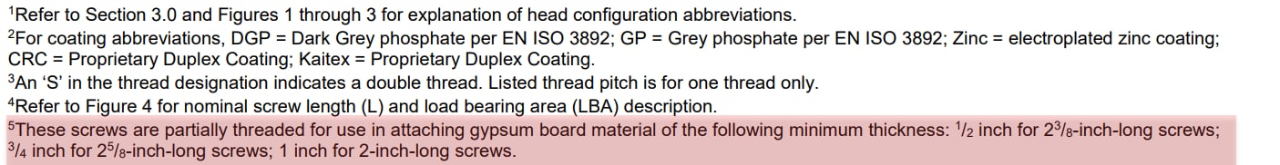

Hilti does not have any testing data regarding the installation of Hilti's KB-TZ2 mechanical anchor or any other anchor type into gypsum roof deck. Depending on the thickness of the gypsum, self-drilling screws may be a consideration. ESR-3891 contains technical data on self-drilling screws used to connect gypsum board materials to steel base materials. Although there has not been specific testing for fastening gypsum to steel, see the attached snippet from Section 4.1 that speaks to screw length and the thickness of the fastened material. Additionally, see footnote 5 below from Table 1 on pages 2 and 3.
