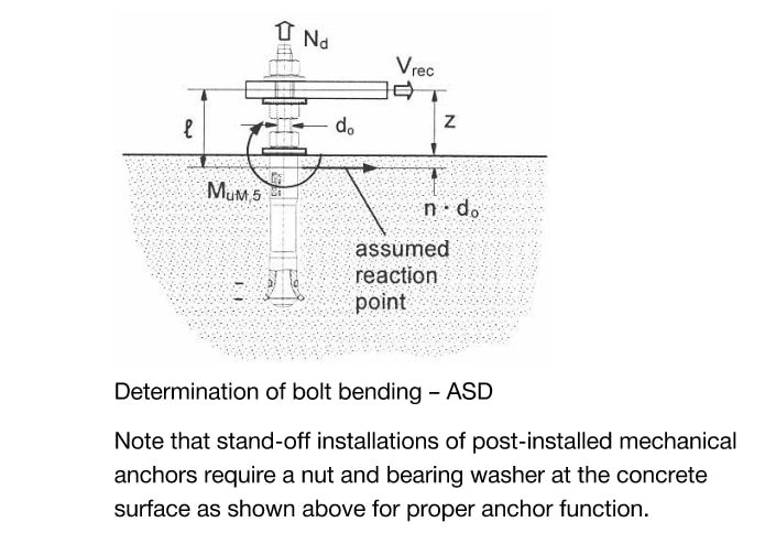

Thanks for the reply Ashley. I can choose standoff with grouting, but when I use this method, should I provide an extra nut at the concrete surface (As opposed to grout surface) and torque it prior to pouring grout ? The technical guide page 29 says "Note that stand-off installations of post-installed mechanical anchors require a nut and bearing washer at the concrete surface as shown above for proper anchor function "
Posted by Anand Sreedharanover 5 years ago
This is what I referred to in the reply above

Posted by Ashley Couronover 5 years ago
Hi A.S.,
The image you are referencing applies to stand-off with clamping and does not apply to stand-off with grouting.
