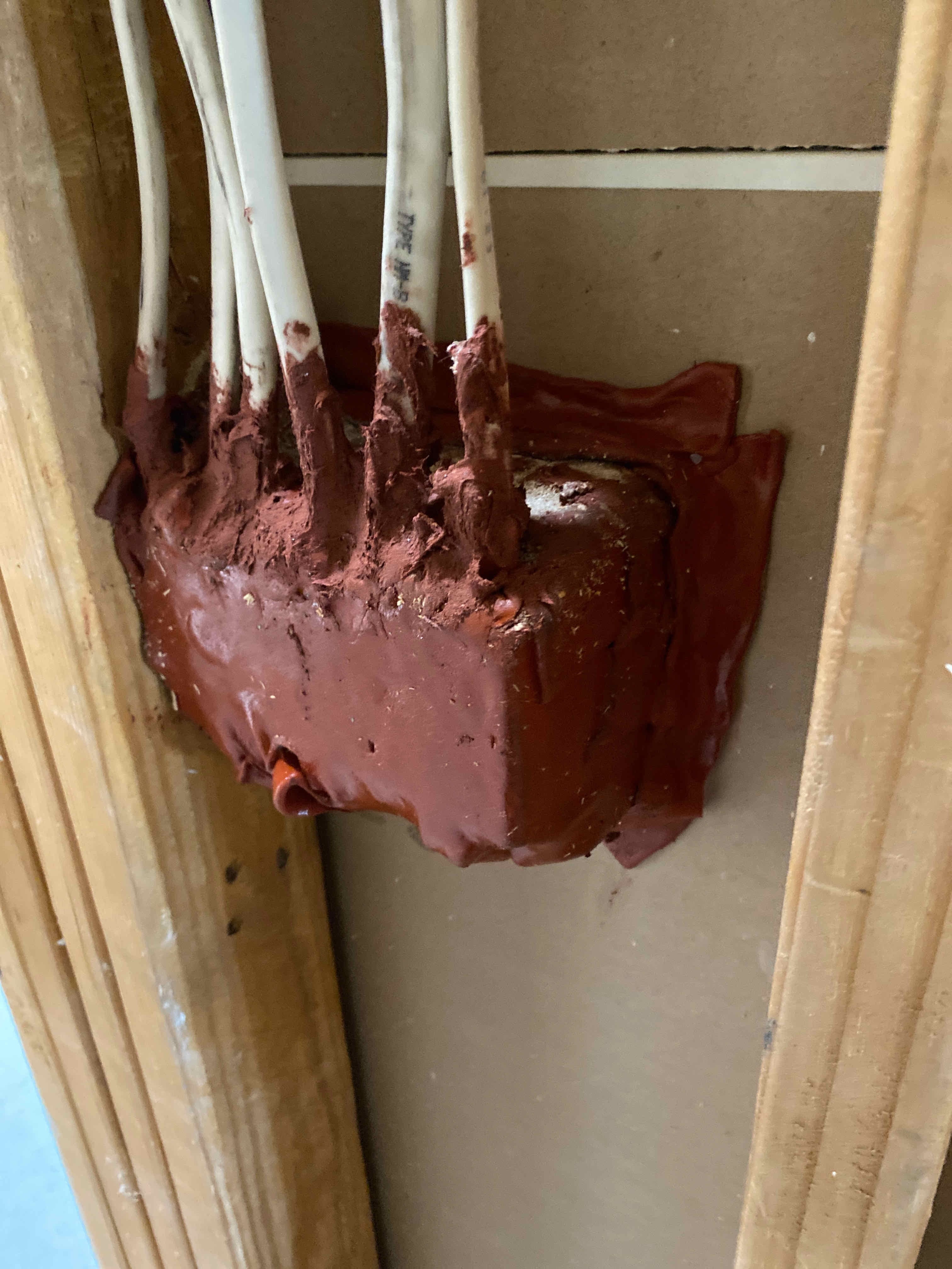

Can you use FSONE with Putty pads to fill gaps?

Both FS-One Max sealant and putty pad are chemical compatible. However for this application, is the putty pad completely covering the box per the CLIV guidance or are you use the FS-One Max per with UL listing, W-L-7277?

Hello, Thank you for the additional information. As long it's installed per CLIV you are good to go since FS-One Max and CP 617 Putty Pad are compatible.

Per the CLIV, then the FS-One is being used to catch and gaps at the wires as the move during trim out.
