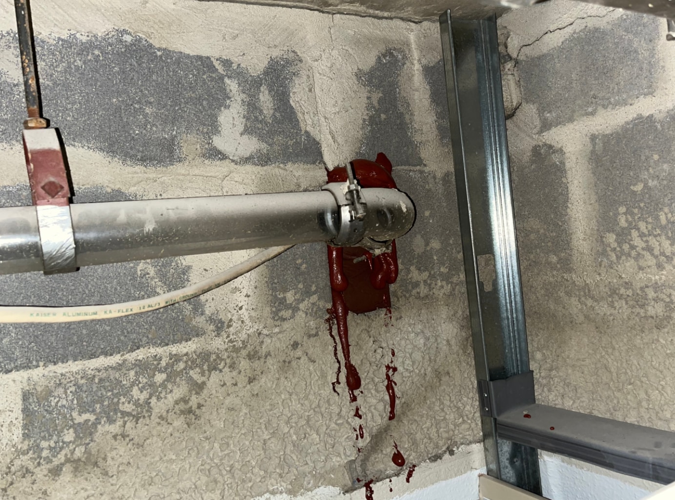

Acid waste glass pipe 2" through cement block wall (2 hour rated) needs proper firestopping. Unable to locate specific UL system in Hilti Library
Penetration,glass pipe

Good day Tomasz,
Attached is CA-J-2118 and CA-J-2675 which both address glass pipe in a block wall. If neither of these systems meet your conditions we could address it with an Engineering Judgment; which will be a custom detail showing your exact application with the firestop components required to maintain the stated ratings. Below is a guide for submitting for an Engineering Judgment.

Thank you , that's exactly what I need!
