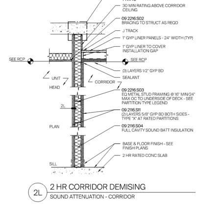

Fire Rating w/ Gyp Removal
Is my customer able to remove the "1" Gyp. Liner to cover installation gap" and the sheet of Drywall above the corridor ceiling?
They would then fire safe inside the stud cavity from the ceiling to the deck. Is this something they can do to keep the rating?

Hilti’s firestop scope is to restore the fire rating of an assembly at penetrations and joints. Because the rating of the actual wall or floor assembly is determined by the design professional or project specifications, we typically rely on the information provided to us when an engineering judgment request is submitted. For this reason, Hilti does not have internal tools for identifying the fire rating of this assembly, and we defer to standard third-party resources.
