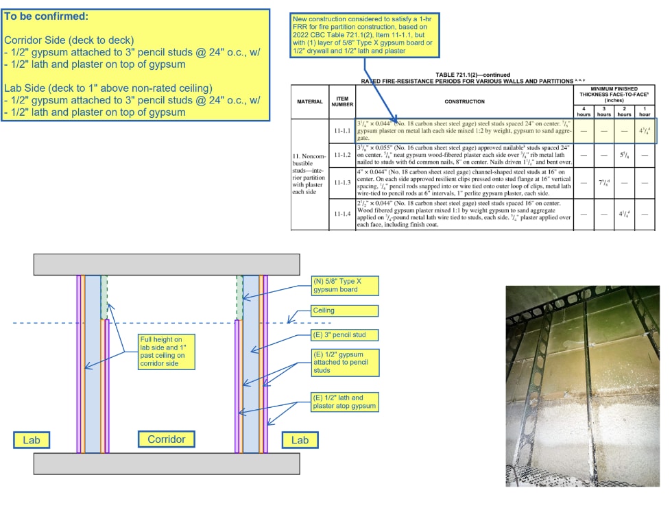

We are routing new MEP penetrations (pipes and conduits, various diameters) through existing 1-hour fire-rated corridor walls and require guidance on compatible Hilti firestopping systems to maintain the rating.
Existing Wall Assembly:
  • Corridor side (deck to deck): 5/8" Type X gypsum board attached to 3" pencil studs at 24" o.c., with 1/2" lath and plaster over gypsum
  • Lab side (deck to 1" above non-rated ceiling): 1/2" gypsum attached to 3" pencil studs at 24" o.c., with 1/2" lath and plaster over gypsum
  • Assembly appears to align with 2022 CBC Table 721.1(2), Item 11-1.1 (1-hour fire-resistance rating for fire partition construction)
Attached: Reference detail and field photo showing existing assembly
Specific Questions:
  1. What Hilti firestopping systems are UL-listed for penetrations through this lath-and-plaster over gypsum assembly?
  2. Are there special installation requirements for penetrations through the plaster layer?
  3. Can system submittals and installation details be provided for recommended solutions?

Hello,
Thank you for reaching out to the Hilti Fire Protection Design Team to assist you with your firestop engineering needs.
We do not have any listed systems for a lath and plaster over gypsum assembly; however, we can address your application through an Engineering Judgment, which will be a custom detail showing your exact application with the firestop components required to maintain the stated ratings.
