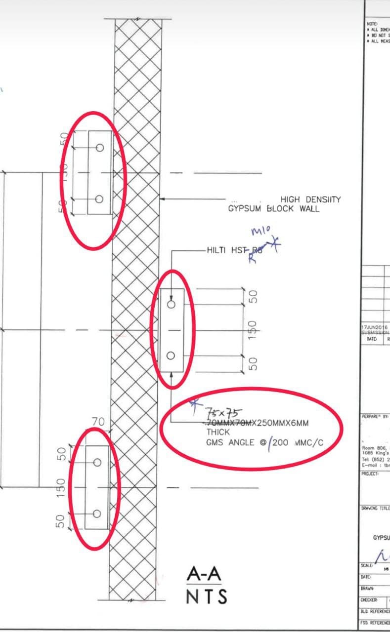

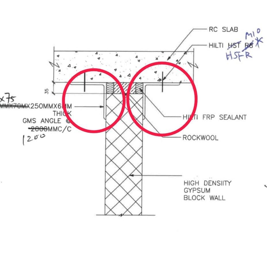

FIRE FINISH 120 CFP-SP WB is it suitable to apply on 75 x 75 x 6mm GMS angle
Steel angle,Hilti Fire Finish 120 WB
1 Reply
Posted by Perla Salcedoover 4 years ago
Hello, yes you can use Hilti Fire Finish 120 CFP SP WB to rate these angles. The intumescent thickness will depend on the hourly rating you need. Please email us for more information at usspeng@hilit.com if you know the rating you need.
