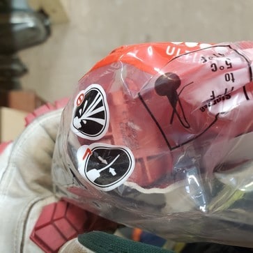

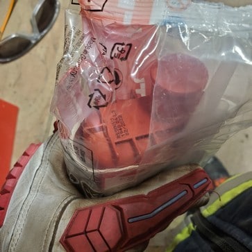

What's the expiry date on chemical anchors ? there is a date on top of hard plastic handling the product but I don't know if that is the fabrication date or the expiry date

Hi Henry,
The date on the top of the adhesive tube is the expiration date.
