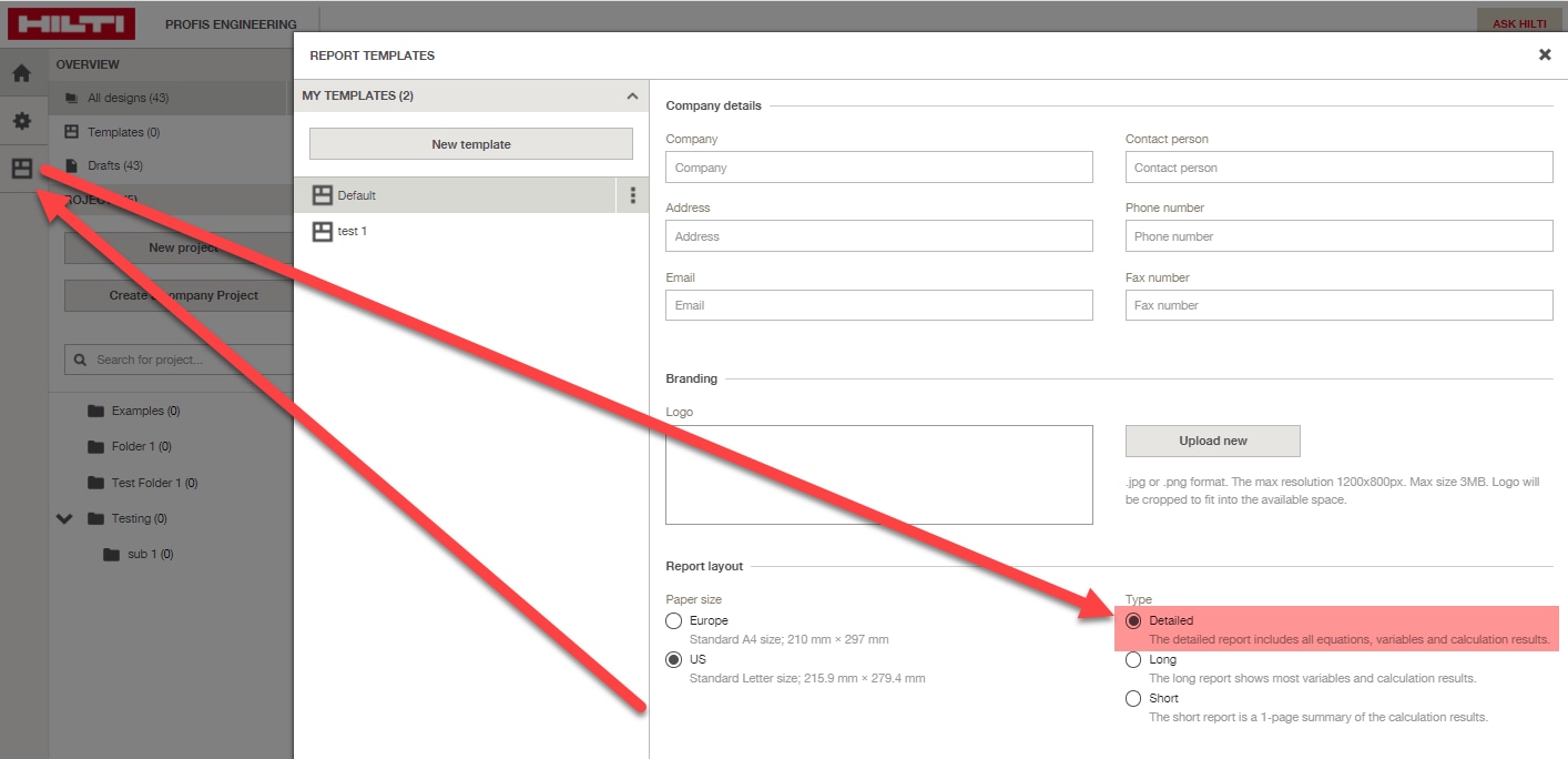

Expanded Results in Report
How can I expand the results in the draft report to include all of the failure mode percentages, not only the critical mode (i.e. steel, concrete breakout, and bond)?
Expand Report,Include all failure modes in report
1 Reply
Posted by Emily about 4 years ago
Hilti Verified
Hi Christopher,
Ensure that a "detailed" report type has been chosen. See image attached.
Best,
Emily
