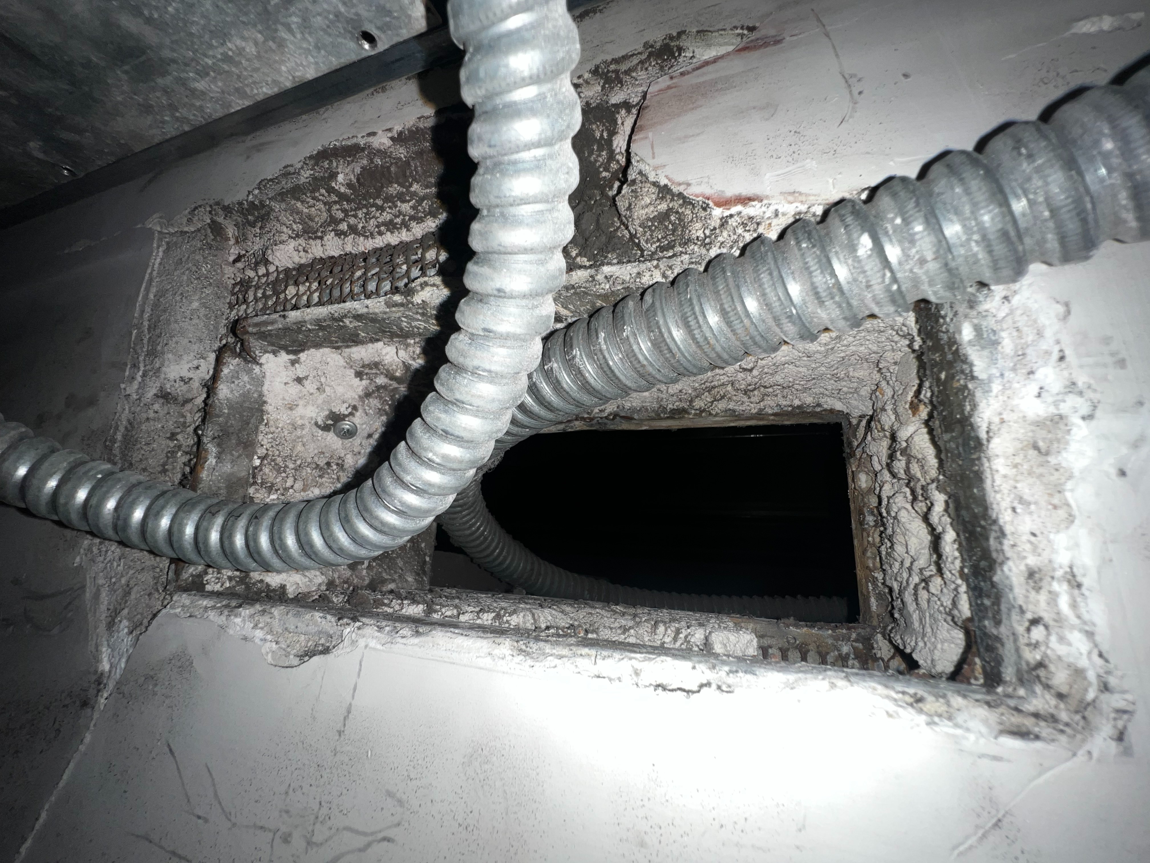

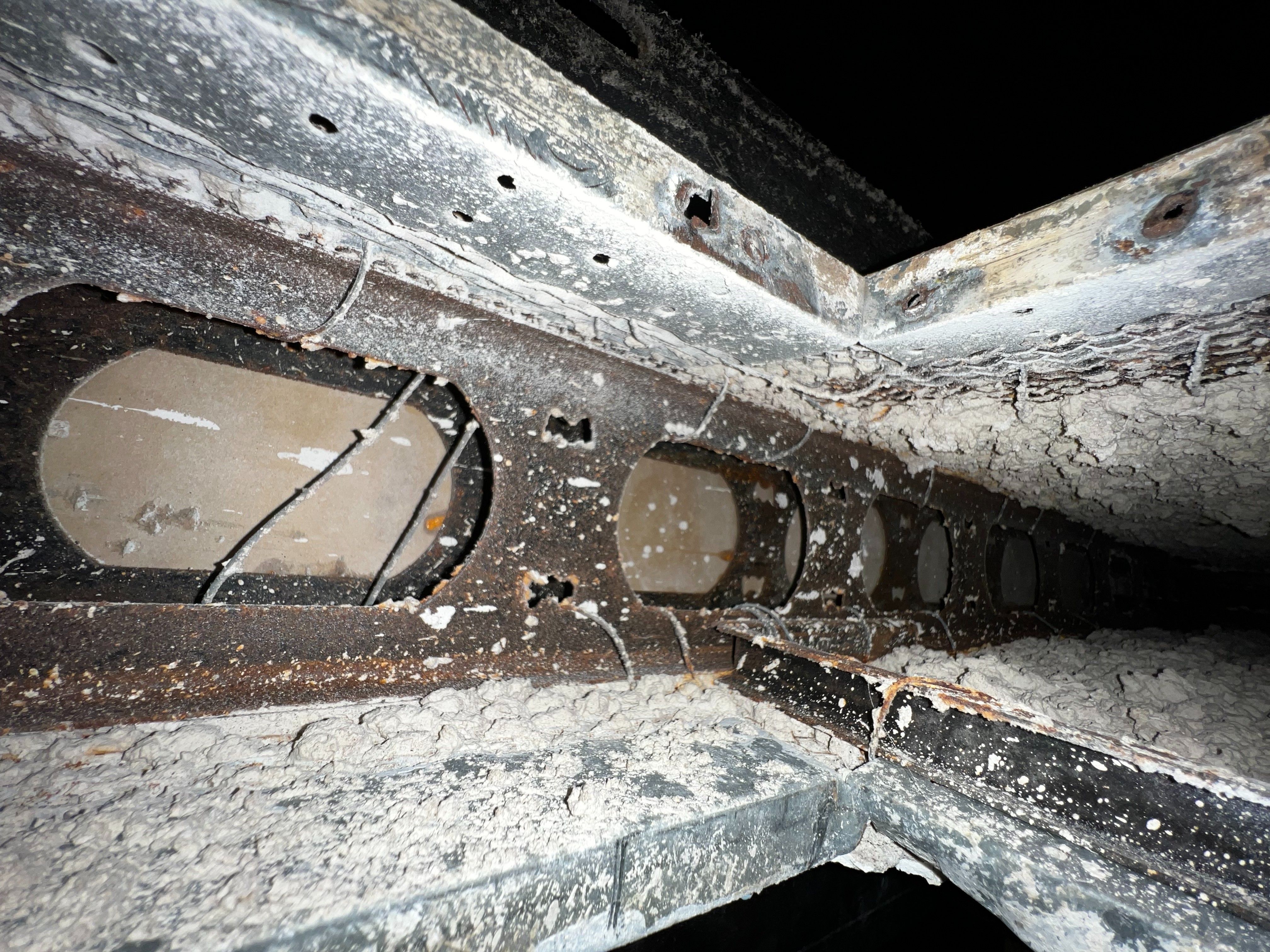

Hi, we have came across an existing elevator control opening that we must patch. Upon observation, this is an antique wall framed using pencil studs. Does Hilti happen to know of a UL that will cover fire stopping inside this opening with a plaster wall framed on pencil studs? I have attached some pictures. Thank you.

Good morning Christian,
Hilti does not have a UL listed system for a penetration through a plaster wall assembly but we can address your application through an Engineering Judgment which will be a custom detail showing your exact application with the firestop components required to maintain the stated ratings.
