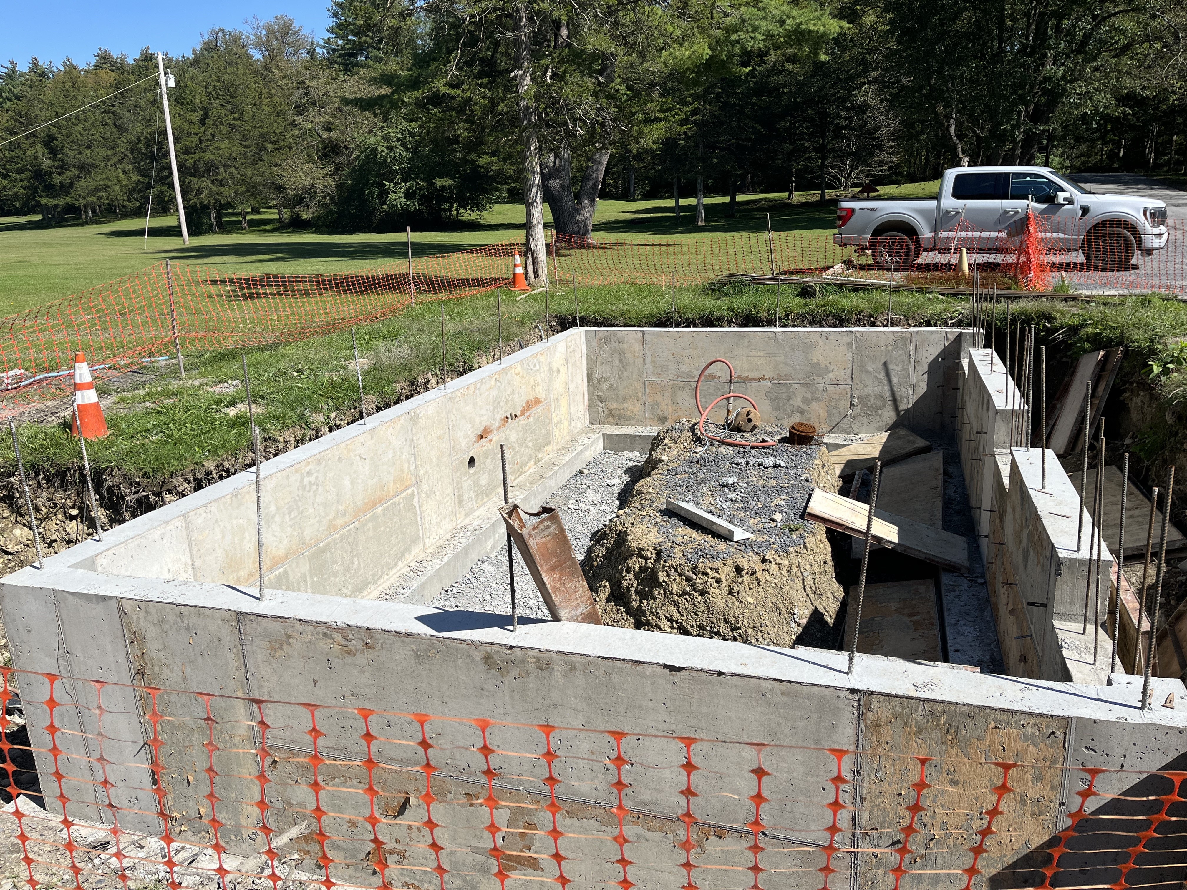

During the process of drilling and grouting #5 rebar utilizing HIT-RE 500 V3, how deep should the embedment be?
Posted by Kordell Costinabout 3 years ago
Does this follow ACI development length? Dowels in a cast-in-place concrete foundation for CMU construction were missed, only solution is to drill and grout more dowels.
