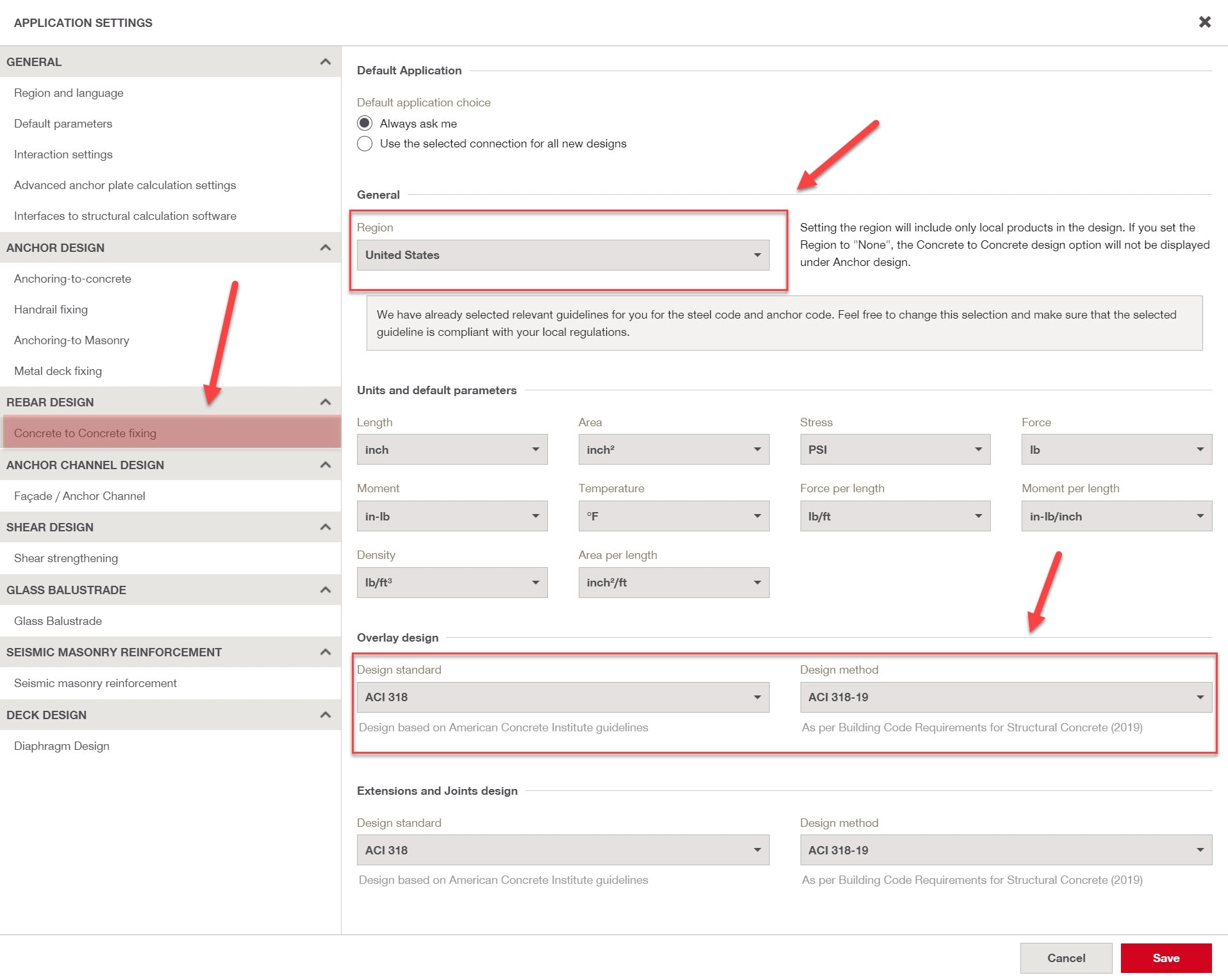

I would like to get software trial copy post installed reinforcing bar to design end simply supported slab according to Eurocode

Hi Refaat, New PROFIS Engineering users will begin with a free premium trail before selecting a license type for the software. The region, design standard, and design method may all be changed in the settings menu at the PROFIS Engineering homepage. For additional assistance, please reach out to hnatechnicalservices@hilti.com or give us a call at 877-749-6337.Regards,Matthew
