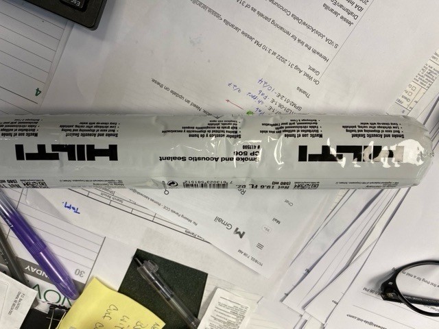

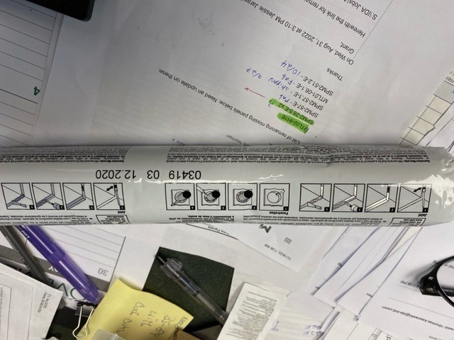

I have discovered several cases of sealant sausages from a project that was completed 2 years ago and wasn't sure if there was an expiration date to use as I was informed there might be. I don't know how to read your production code so I'm posing the question to know whether or not I can use or need to dispose of it

I have attached a snip from the CP506 product data sheet to this response. The shelf life for the product is 24 months from the date of manufacture.
