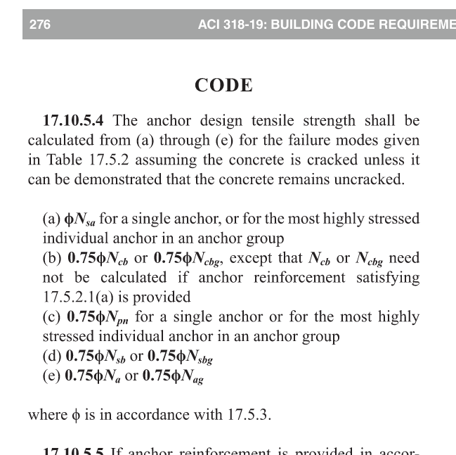

Does the Hilti Anchor software account for ACI 318-19 17.10.5.4 or ACI 318-14 17.2.3.4.4?
Posted by Jordan Carnealalmost 3 years ago
In using the Hilti anchorage software, I was not able to find either a check box or acknowledgement to the Code requirement from the code sections listed in the title. Can someone please point me to where it might be, or inform if high seismic design per ACI 318-19 Section 17.10 is not addressed with this software?

Hi Jordan,
PROFIS Engineering accounts for both ACI 318-19 17.10.5.4 and ACI 318-14 17.2.3.4.4. For more information, please see the PROFIS Engineering Anchoring to Concrete Design Guide beginning on page 78.
