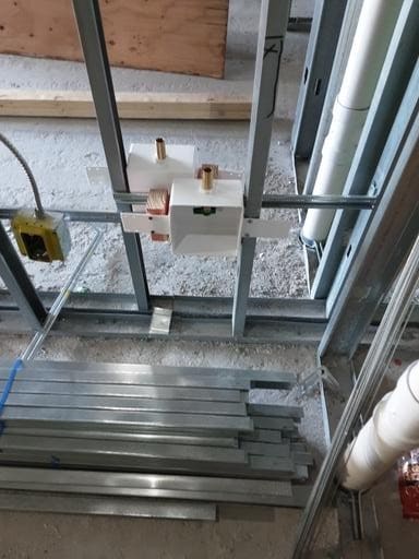

Do you have a product that can cover a plastic ice maker box for a fire rated wall that meets UL listing
We have a project where the contractor has installed plastic ice maker boxes in fire rated wall and need a product like putty pads to cover it to meet the fire rating and be UL listed. Do you have such a product and if so what's the model number?

Thank you for reaching out to the Hilti Fire Protection Design Team to assist you with your firestop engineering needs.
We can address your application through an Engineering Judgment which will be a custom detail showing your exact application with the firestop components required to maintain the stated ratings.
