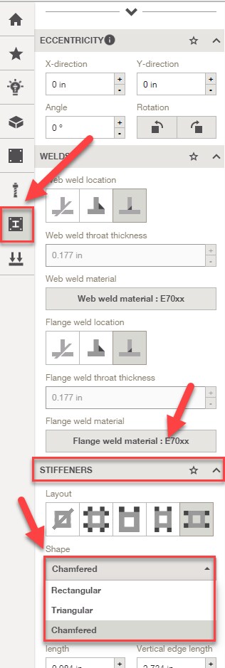

I am trying to create stiffener plate as shown in the photo below. I am having trouble creating this in Profis.

To add stiffeners to your design in PROFIS Engineering, please go to the "Profiles" tab. The shape, dimensions, and layout of the stiffeners may be adjusted here when designing with the CBFEM calculation type.
