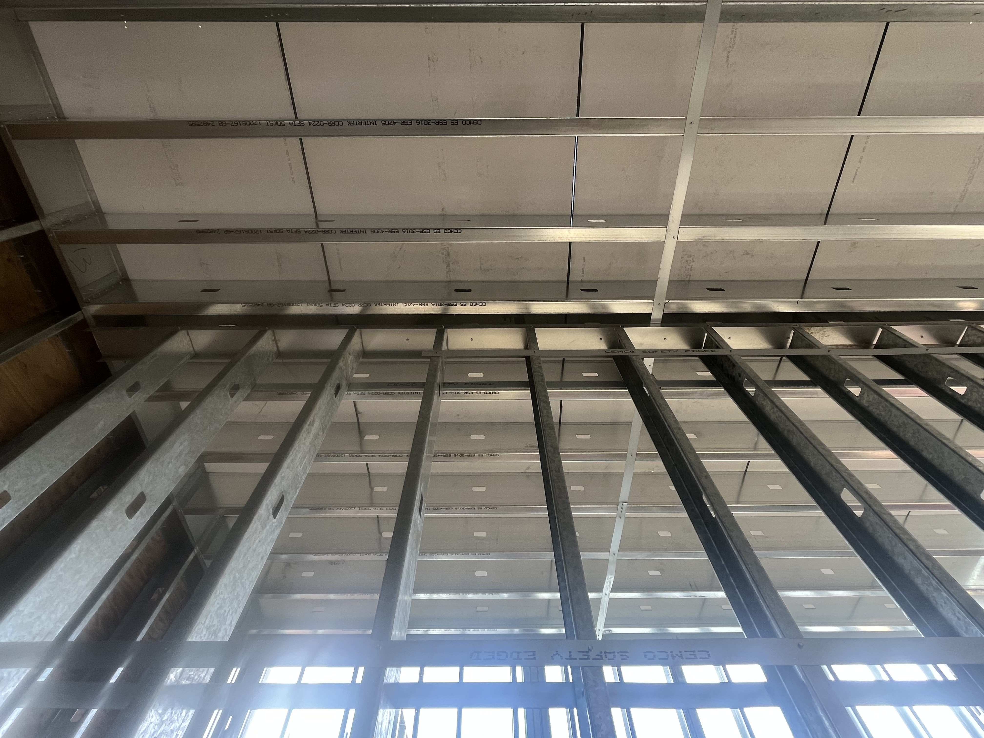

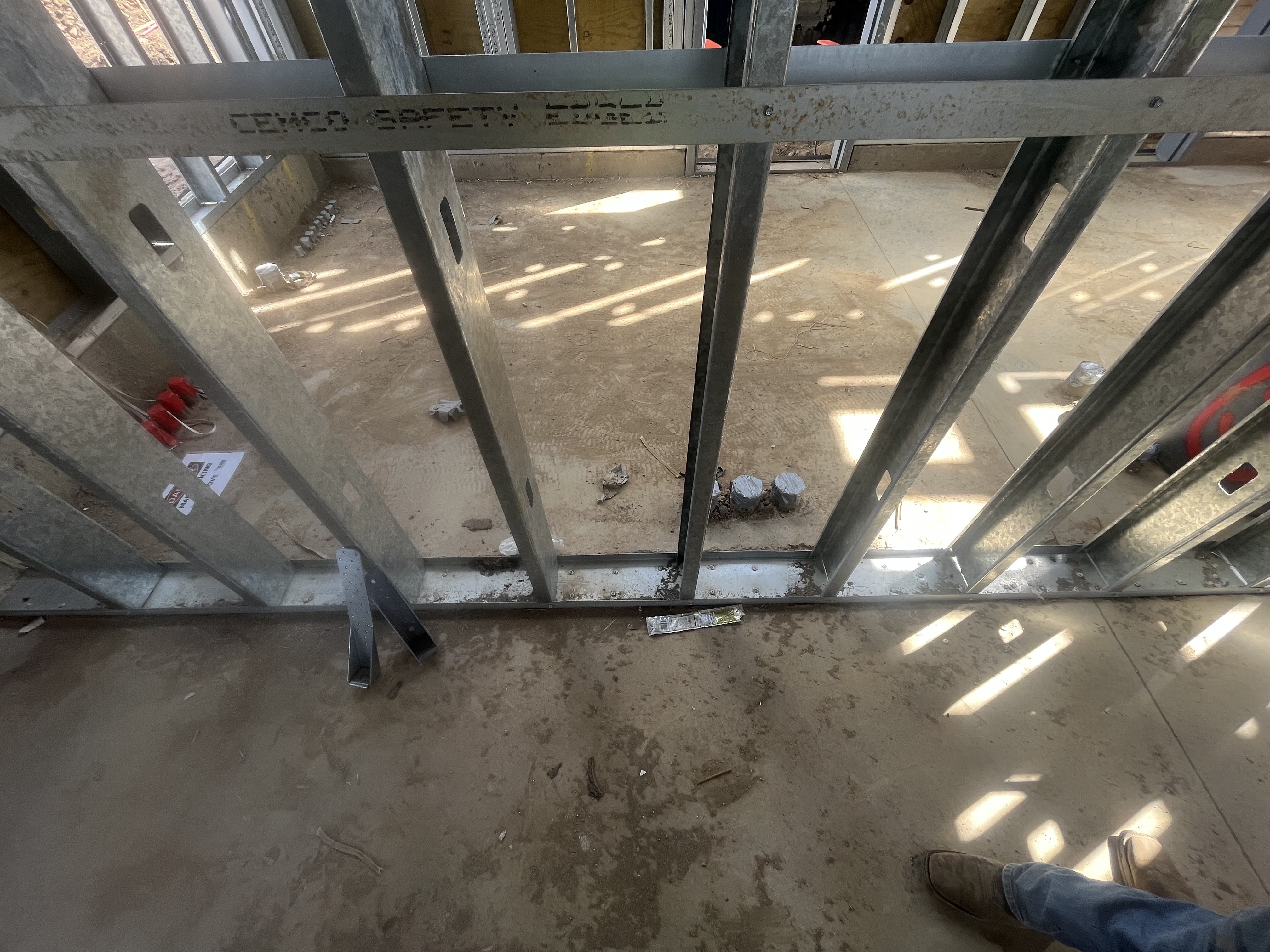

I have a new structure in Boulder at CU where i framed the walls and roof joists connecting to them. There is a callout to follow UL 419 for a couple rated walls and i am not sure how to properly fire rate when the deck above carries no rating.

It sounds like you have a ASTM E 2837 situation here. If you could submit for an engineering judgement
through www.hilti.com/EJ We would be happy to provide you with a solution that fits your needs. We currently have
one listed system (CJD-0004) that could possibly fit your case. If not, we would be happy to get you a solution with your firestop product of choice depending on your conditions.
