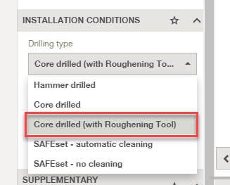

Profis online program does not allow core drilling for cracked concrete. However, in my case the concrete will not be cracked at the time of drilling. It might have flexural cracks later, after full loading. Can you please explain whether this warning: "Wet holes, diamond core drilling and cracked concrete does not work together" can be ignored if the concrete is not cracked at the time of core drilling?

Hi Kivanc,
For installation into cracked concrete, a core drilled hole must be used with a roughening tool. Selecting the drilling type option “Core drilled (with Roughening Tool)” in PROFIS Engineering will eliminate the error message that you are seeing.
