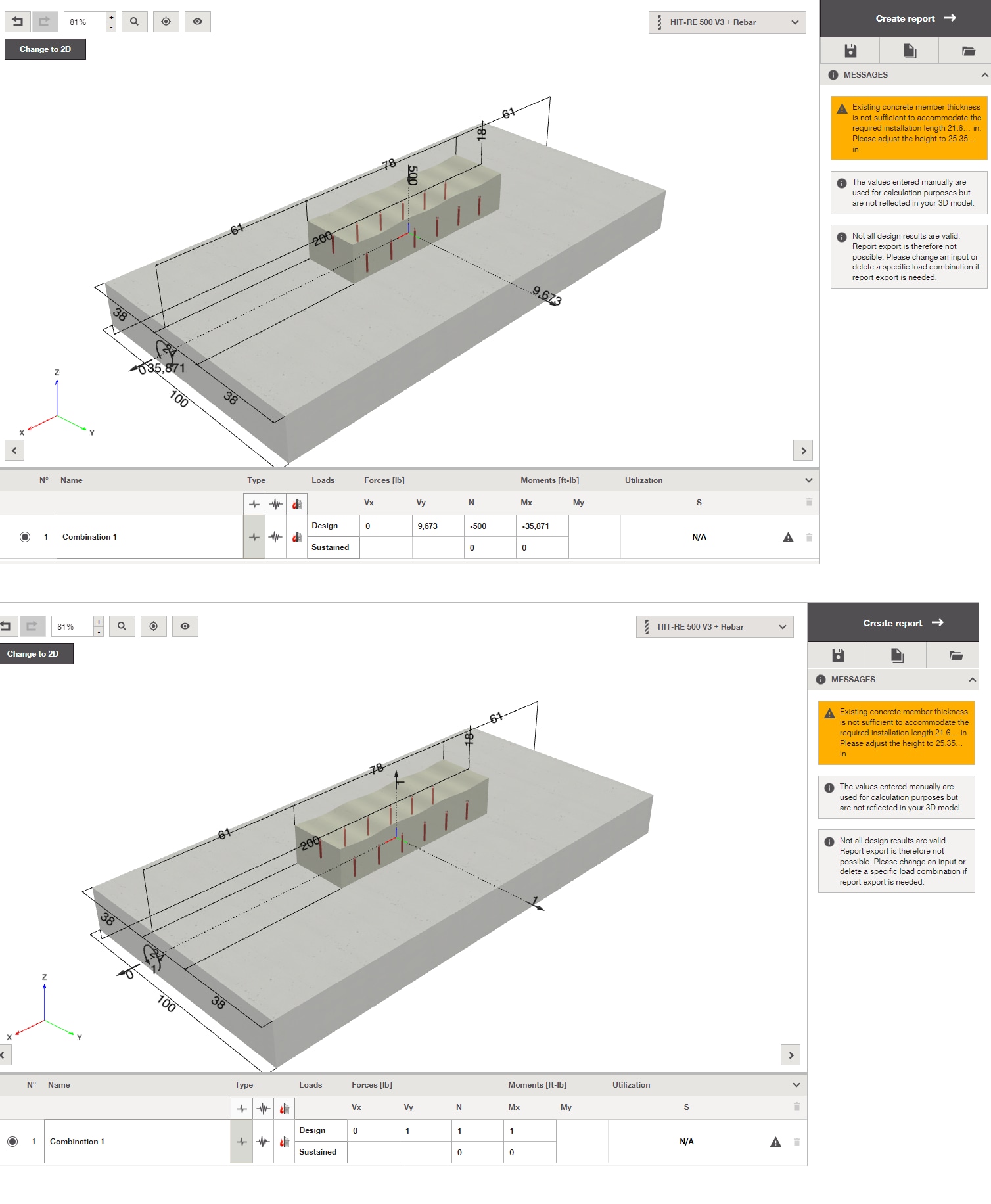

Is the Concrete-to-concrete design module working? I tried decreasing the loads unrealistically small to see if it affects the result, but a still get the same message (please see attached file)

Based on the image, the software has determined that a larger concrete thickness is required for your design parameters. For more information regarding post-installed rebar design, please refer to Hilti's Post-Installed Reinforcing Bar Guide.
If you have further concerns or questions, please email your ".pe" file to hnatechnicalservices@hilti.com.

According to the attachment provided earlier, it seems that 25.35 inches of thick concrete is needed to withstand 1 lb of tension and shear. However, this information appears to be questionable.
