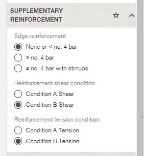

I am designing post installed epoxied anchors embeded into the top of a concrete column. The demand on the anchors is lateral and as a result the main failure mode is concrete edge breakout. The column is confined and has ties throughout the full embedment of the anchors, is there a setting in Profis to either neglect concrete breakout or account for the confinement? Do you have recommendations on how to approach this.

Hi Angel,
You are able to add Supplementary Reinforcement in PROFIS Engineering within the base material tab, see attached file. For further assistance, please reach out to hnatechnicalservices@hilti.com.
