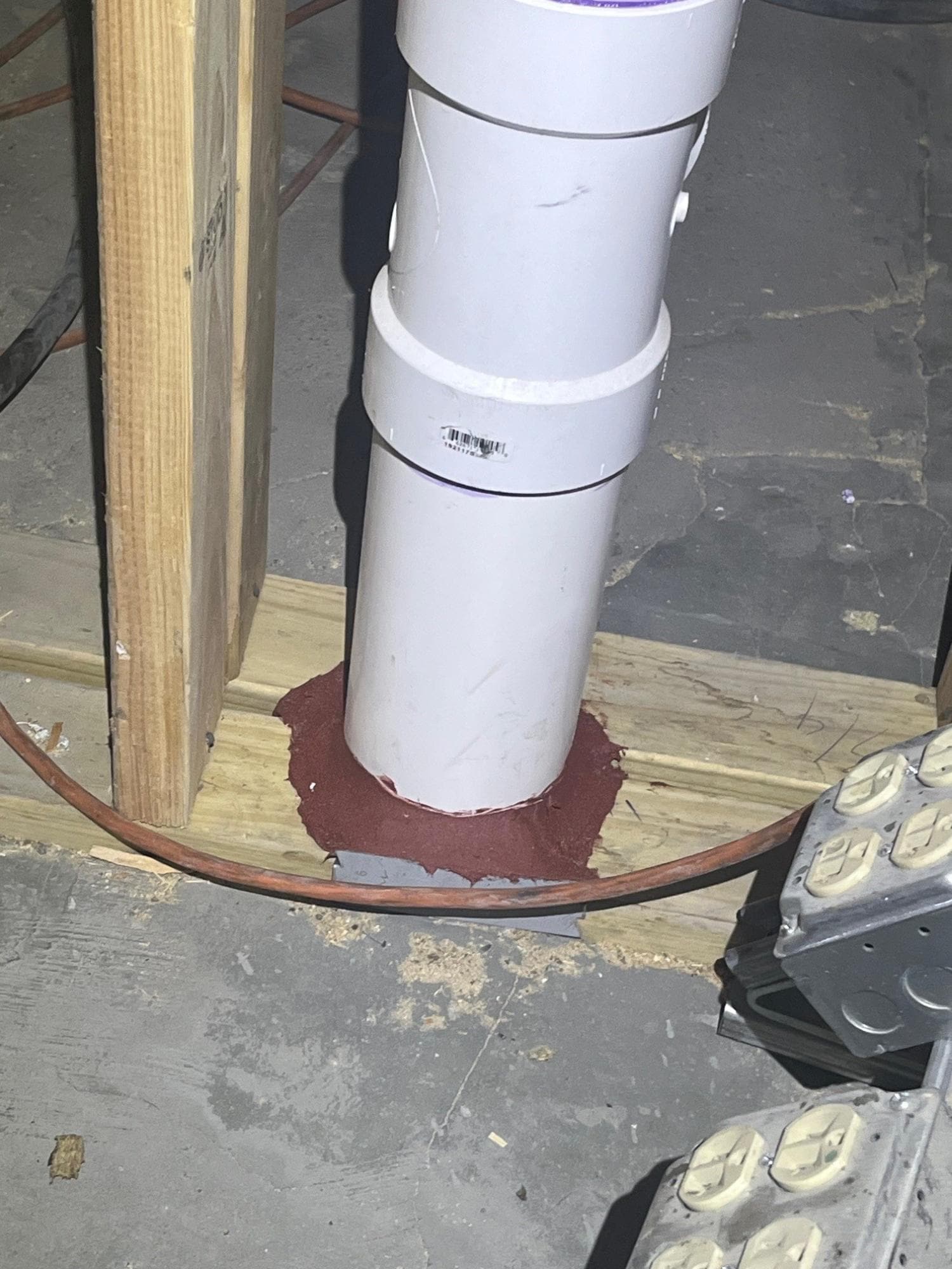

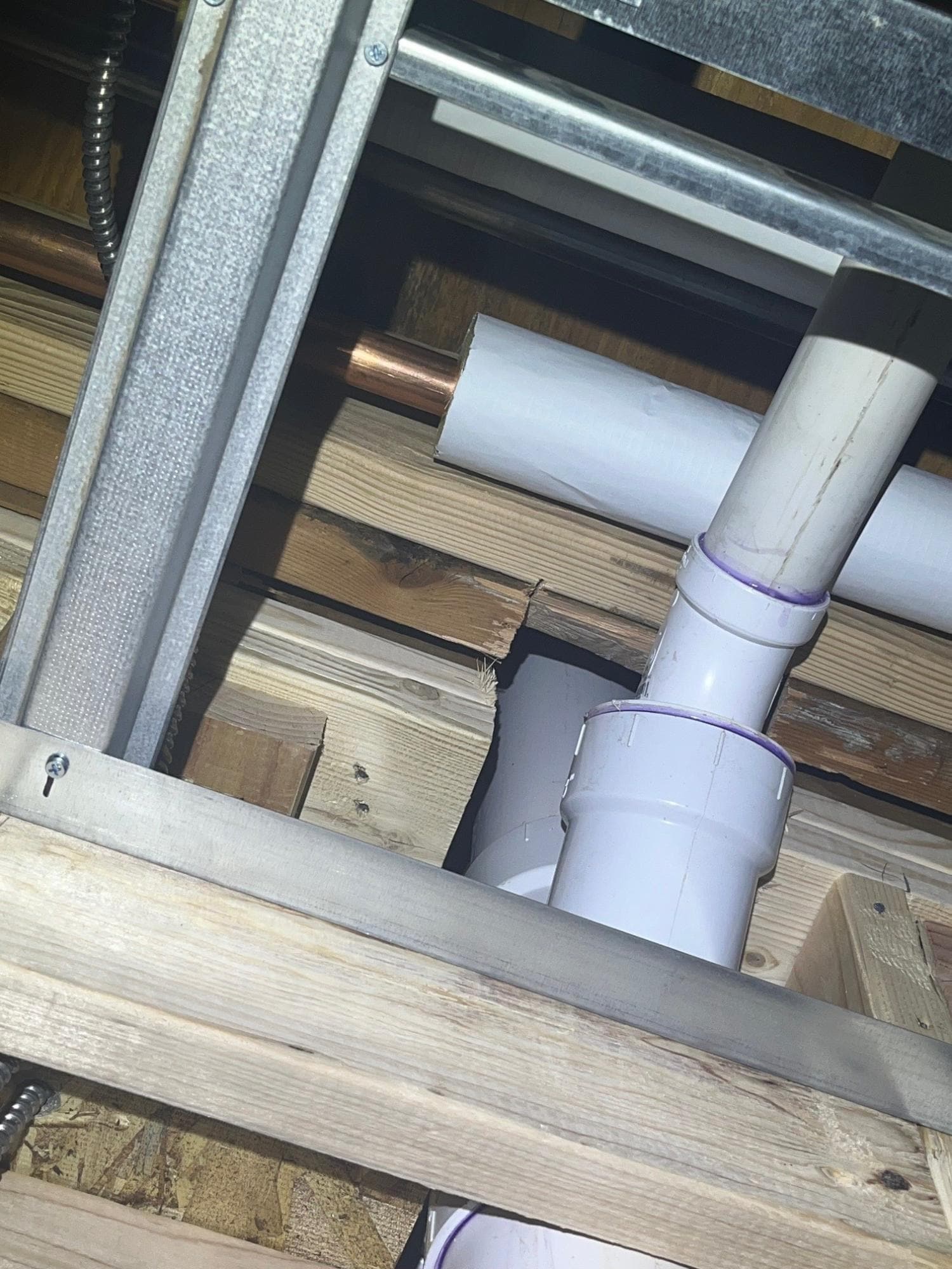

We have vent piping going through a rated floor up through the roof. between the floor does the pipe need to be collared if it is 3"?

Looking at the pictures Hilti would not have a UL listed system for you application and therefore we would need to look at this an Engineering Judgement (EJ). Please see below on how to submit an EJ.
