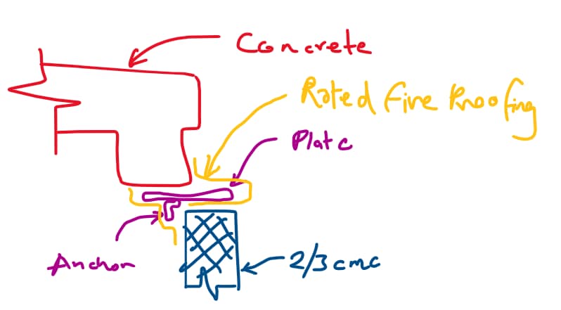

Is there a detail report for the following condition where a rated CMU(at head connection) meeting a rated intumescent metal plate? CMU is 3 hour rated.
rated,CMU,intumescent,metal

We do not have any listed systems for a 3 hour CMU wall meeting a rated steel plate; however, we should be able to address your application through an Engineering Judgment, which will be a custom detail showing your exact application with the firestop components required to maintain the stated ratings.
