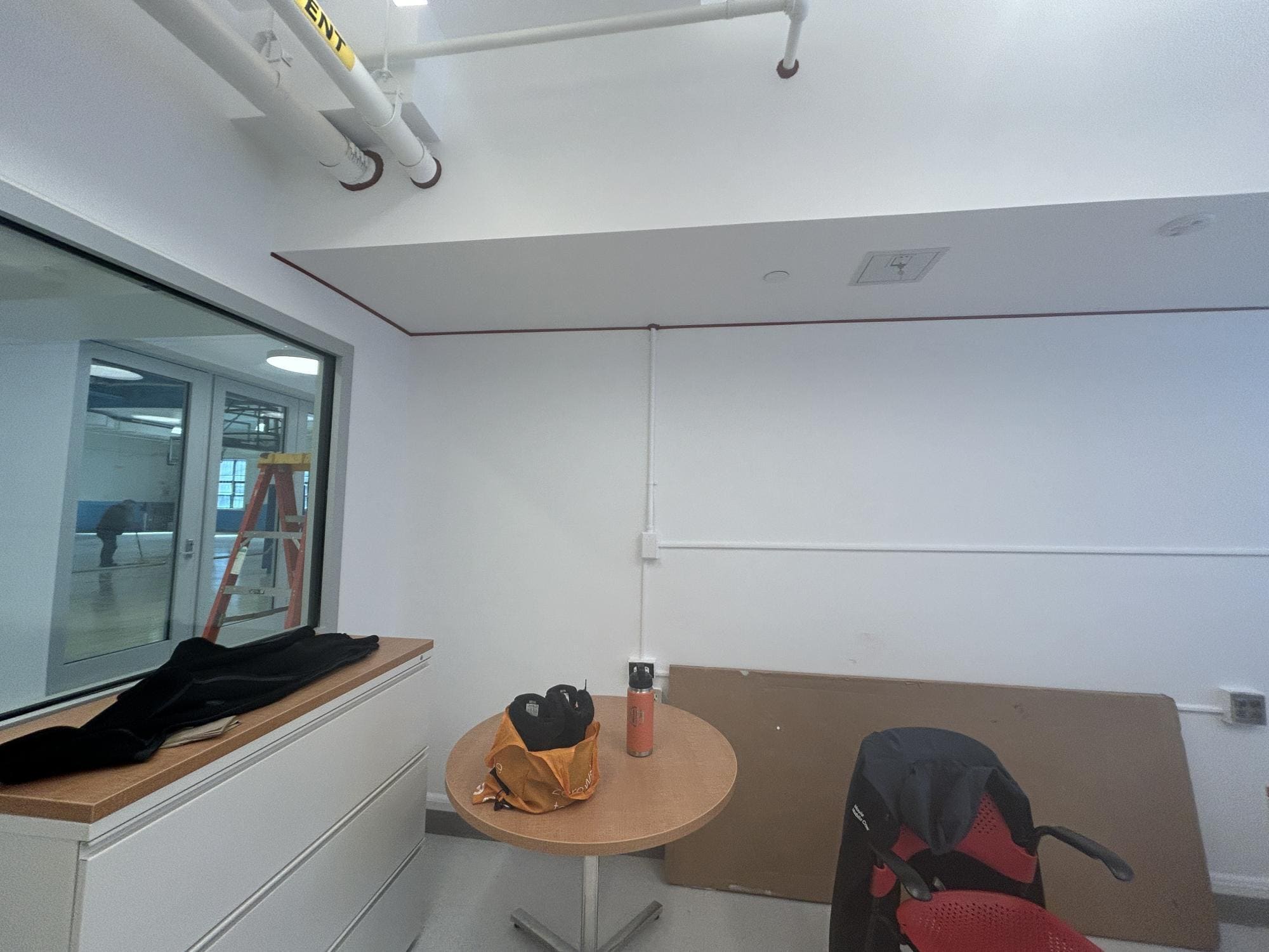

We have CFS-S SIL GG (red) installed at pipe penetrations through rated walls (white). After substantial completion, we noticed that this sealant cannot be painted over.
What would you recommend we do if we want to paint over it at this stage?
