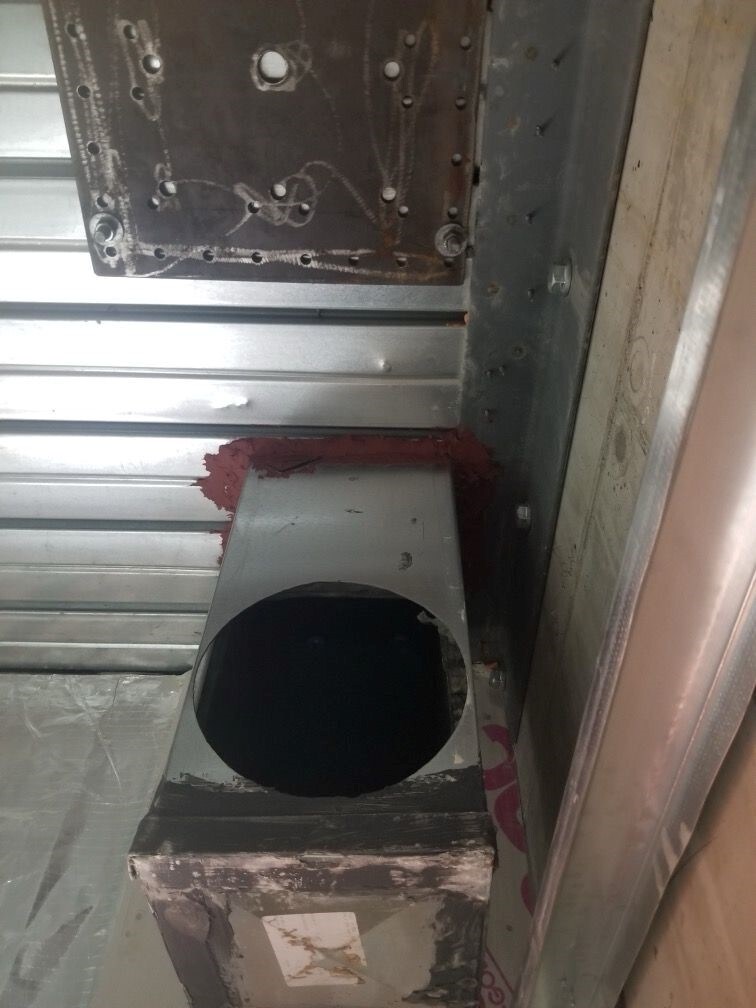

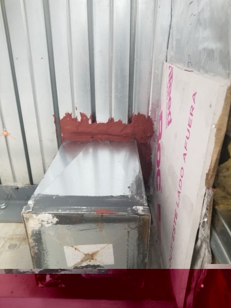

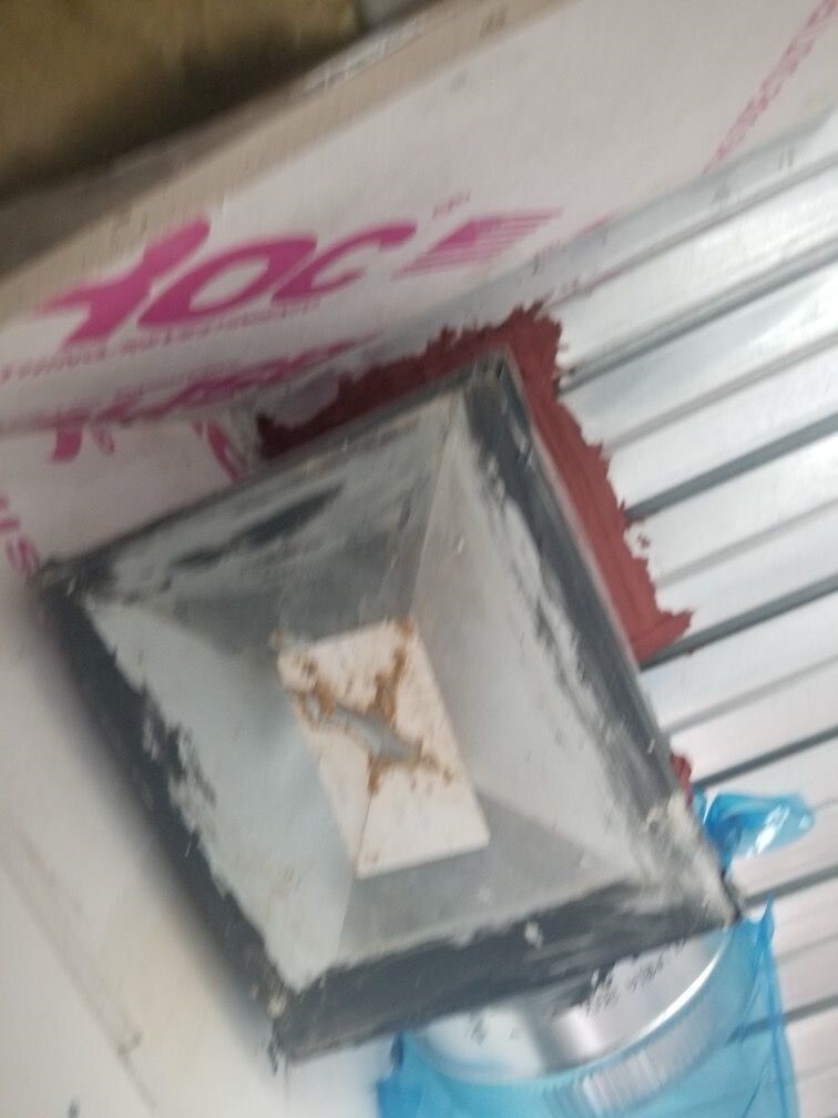

Can we install CAJ-7111 from below, if no access from above
Posted by JOHN SAARIabout 2 years ago
We need an EJ, because we had to install CAJ-7111 from below, because the contractor blocked all access from above.
Project is Somm Hotel & Spa, Woodinville, WA.
install from below,1 hour rating. Sheetmetal angle install
1 Reply
Posted by Nathaniel Crawfordabout 2 years ago
Hilti Verified
Hello John - We cannot support this solution as shown in the pictures for CAJ 7111. Depending on the size of the duct and other parameters, CAJ 7104 may work for you. If not, you will need to submit for an Engineering Judgment request. With this being in a concrete floor over metal decking condition, an EJ will likely be required here.
