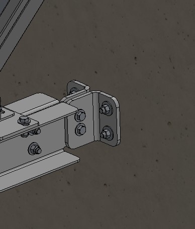

Hello,
Would anyone know if I need to include eccentricity for this connection? If so, how would I go about modeling this in Hilti? Or is it manual calc?
eccentric shear force,connection

Hi Justin,
The decision to consider eccentricity in a design is at the discretion of the Engineer of Record. Additionally, if you decide to consider eccentricity, an eccentric load can be modeled within PROFIS Engineering.
