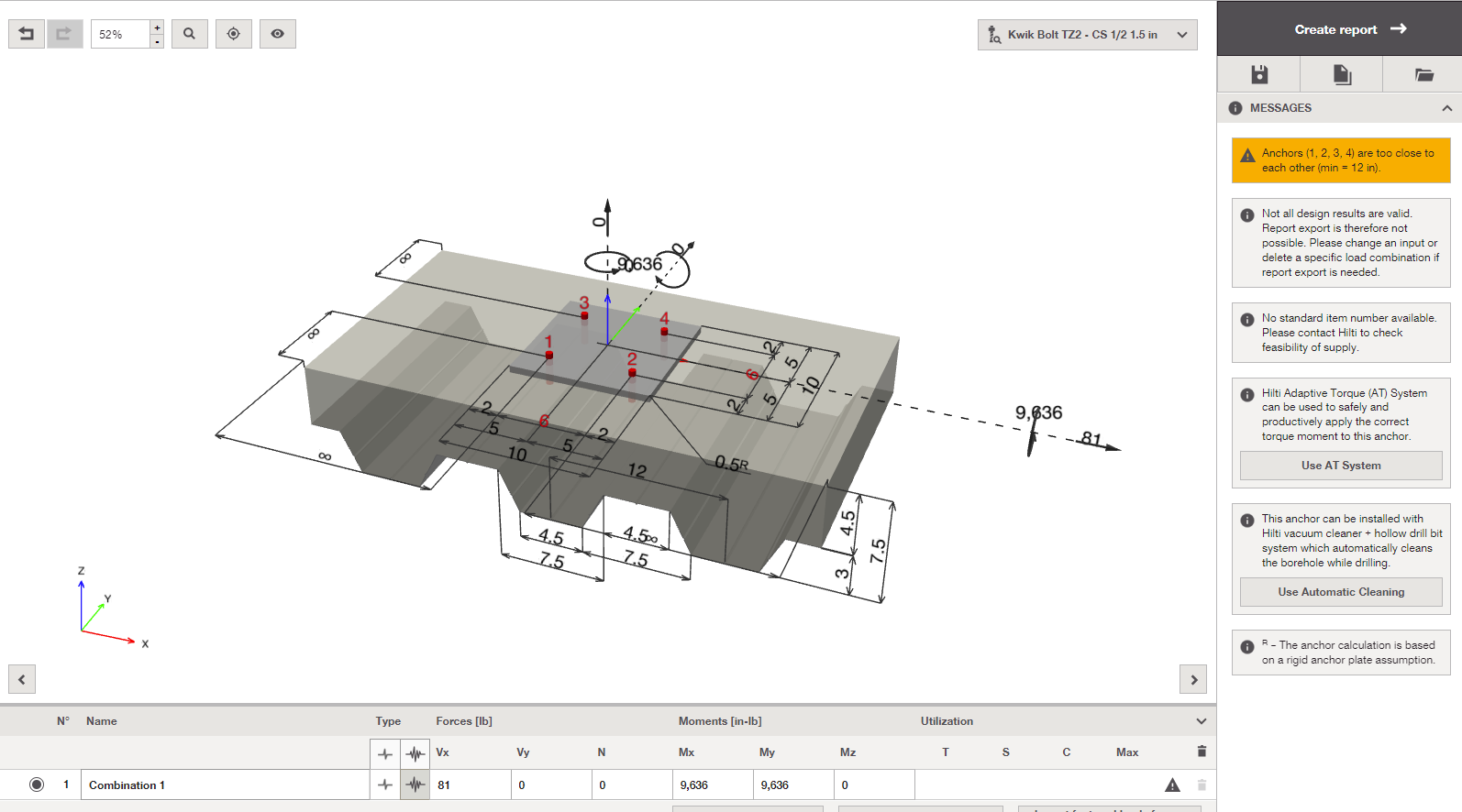

The ICC report indicates that the minimum spacing between 1/2" DIA bolts can be 6" or 9" based on embedment depth. However, the software is showing an error with a note saying that min spacing is 12" (please see attached). Why is it different than the ICC report? It seems that 12" is too large for the spacing. Thank you!

Hi Sara,
Anchor spacing is dependent on the specific anchor being used. Please email your .pe file to hnatechnicalservices@hilti.com so that we can further assist you.
