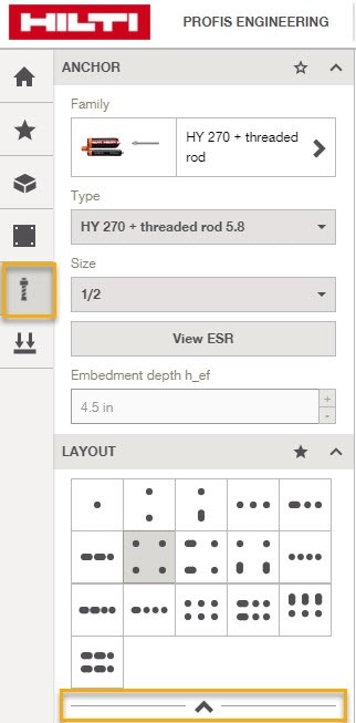

Can the ledger angle show more than 2 anchors?

Hi Christopher,
Within Anchoring-to-Masonry in PROFIS Engineering, there is an option to add anchors from left panel: under Anchor and Layout (screen shot attached). The software will then perform a geometry check to ensure that the product’s design parameters are satisfied with the additional anchors (i.e. spacing, edge distance, etc.).
