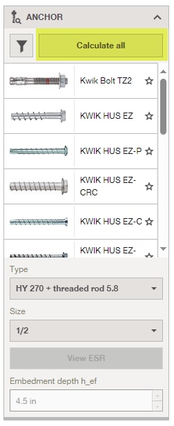

Hi Chad,
Within PROFIS Engineering there is a "Calculate All" option within the anchor drop down menu that will calculate all possible anchoring options. I have attached a snippet for your reference. If you would like further assistance, please email your ".pe" file to hnatechnicalservices@hilti.com.
Regards,
Ashley
Profis engineering software
