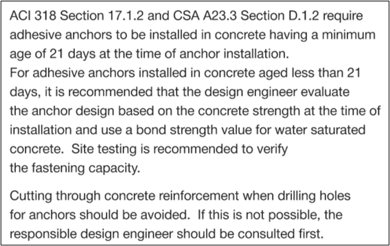

For information on anchoring into green concrete, please reference Hilti’s Anchor Product Technical Guide Section 2.1.2 on pages 10-11. Click here to access the guide from Hilti’s website. Information on adhesive anchors installed into concrete that has cured less than 21 days can be found in the attached image. Typically, site testing is recommended to verify the fastening capacity into green concrete applications.
