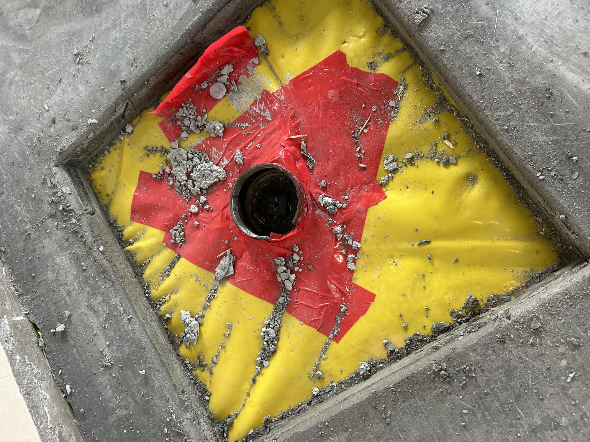

There are multiple existing sleeves (max 4" diameter) in a concrete slab that need to be infilled and maintain a 2HR fire rating. Is there a Hilti solution to this?

We do not have a listed system for multiple blank sleeves in a concrete slab; however, we can address your application through an Engineering Judgment, which will be a custom detail showing your exact application with the firestop components required to maintain the stated ratings.
