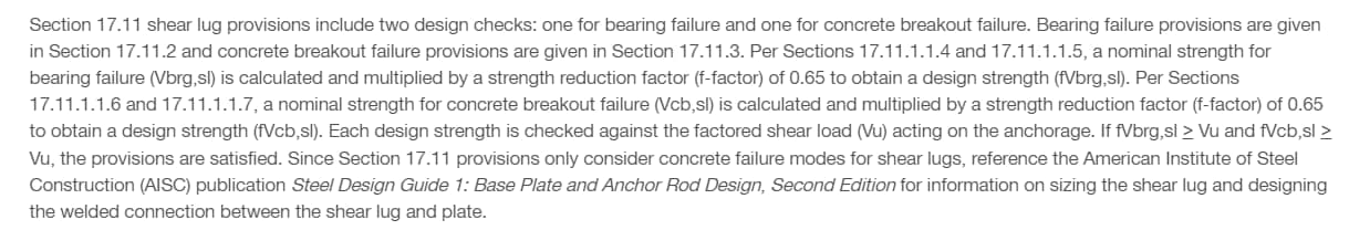

Hi Charlie,
Attached below is a snippet from an Ask Hilti article discussing integrating shear lug design with ACI anchoring-to-concrete provisions.
For further assistance, please email your ".pe" file and any additional questions to hnatechnicalservices@hilti.com.

Posted by Charlie Gardneralmost 3 years ago
When doing a hand calc to calculate concrete shear breakout in example 4.9 in the attached document, I'm getting a capacity of about 12.8 kips, which would satisfy the shear design. I believe the Profis program is incorrect in this case.
