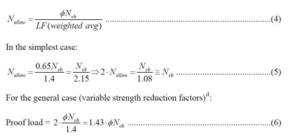

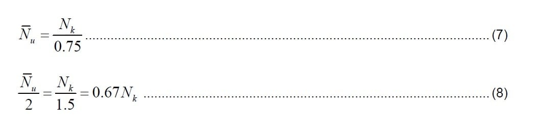

4.4.4 Derivation of Proof Loads for Strength Design
Anchors are designed using strength values calculated as the 5% fractile or "characteristic" resistance (defined as the value that would be exceeded by 95% of the population with a confidence of 90%). In Appendix D, it is assumed that the characteristic value is 0.75 times the mean ultimate resistance (based on an assumed COV = 15%).
Special Instructions Guidelines for Post-Installed Anchors Equation 1
That is, the characteristic resistance divided by 1.5 yields twice the "allowable". However, if we use the current definition for the allowable load based on LRFD:
Special Instructions Guidelines Equation 2
Per subpara. 1.1.1 of the CAN, OSHPD takes this as 1.5φNcbwhich implies a weighted average load factor of 1.33 instead of 1.4.
Where the resistance has been reduced by 0.75 for seismic in accordance D.3.3.3, OSHPD asks that the proof load be calculated using a factor of 2.0 instead of 1.5 as follows:
Proof load = 2.0⋅0.75⋅φNcb=1.5⋅φNcb
For adhesive anchors, standard practice has been to establish proof loads at 50% of the mean bond strength or 80% of the rod yield, whichever is less (For obvious reasons, proof loads should never result in steel yield). Taking 50% of the mean bond strength:
Special Instructions Guidelines Equation 3
which would be appropriate for a global safety factor of 4 on the mean resistance.
