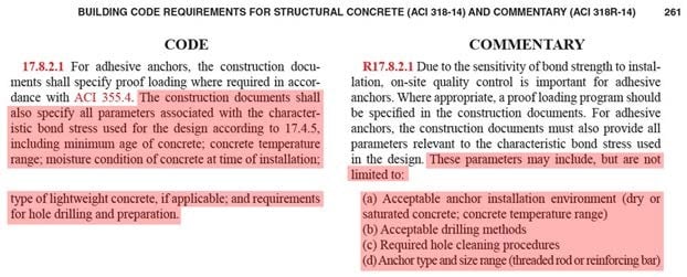

ACI 318 17.8.2.1 acknowledges that the bond stress of adhesive anchors is dependent upon a variety of factors and requires structural engineers to consider and include those parameters in their design and specification. There are many factors, but three important and easily overlooked factors are:
  • Concrete temperature range at time of installation
  • Moisture condition of concrete at time of installation, and
  • Hole drilling and preparation.
Where can I find information about how these factors are addressed in my adhesive anchor design?
