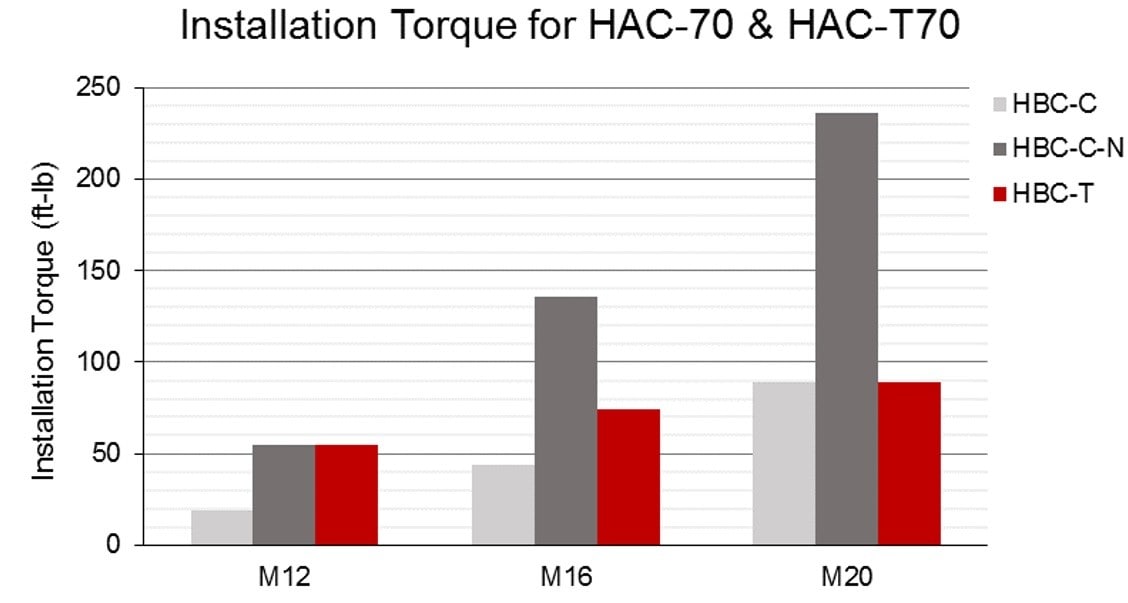

Finally, based on the feedback from installers, Hilti developed a serrated anchor channel portfolio (HAC-T) to offer an alternative code-compliant solution that reduces the installation torque by over 50% and without compromising cost and performance, making it a unique solution of its type. Hilti Serrated Anchor Channels and Serrated t-bolts come with pre-formed serrations. In contrast to the notch bolt with smooth channel profiles, the higher installation torque is not required for the serrated anchor channel system to create the mechanical interlock between the channel lips and t-bolt. Figure 3 illustrates the serrated anchor channel (HAC-T) and serrated T-bolt (HBC-T). Moreover, it provides a cross-section of the two standard HAC-T profiles and three different standard sizes. Length of the channels vary from 6 inches up to 19 feet.
Figure 3: Cross-sectional View of HAC-T50 and HAC-T70 and Isometric View of HAC-T and HBC-T
HAC-T BENEFITS
Hilti HAC-T serrated anchor channels with HBC-T serrated T-bolts are approved under ESR-3520 for strength design according to AC232 methods for cracked and uncracked concrete, normal and light-weight concrete, as well as seismic design categories C-F and with shear loading along the longitudinal axis of the anchor channel. The interlock between the serrations on the channel lip and the T-bolt provides longitudinal slip resistance using only about half* the installation torque required by alternative solutions and similar systems, speeding up the installation time while reducing muscle fatigue.
*Installation torque based on largest channel profile with M16 or M20 T-bolts.
Figure 4: Comparison of Installation Torque for Different Channel Bolts (T-bolts)
